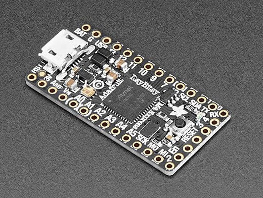

The Adafruit ItsyBitsy M4 Express board.
