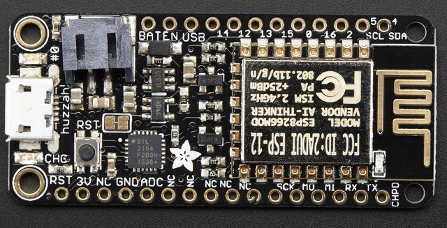

The Adafruit Feather HUZZAH board (image attribution: Adafruit).
Below is a quick reference for ESP8266-based boards. If it is your first time working with this board please consider reading the following sections first:
