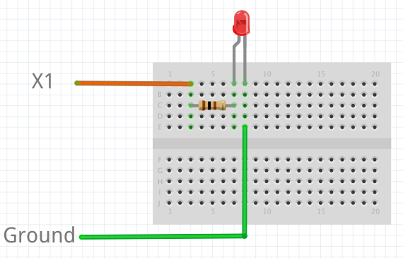

For this tutorial, we will use the X1
pin. Connect one end of the resistor to X1
, and the other end to the anode of the LED, which is the longer leg. Connect the cathode of the LED to ground.
